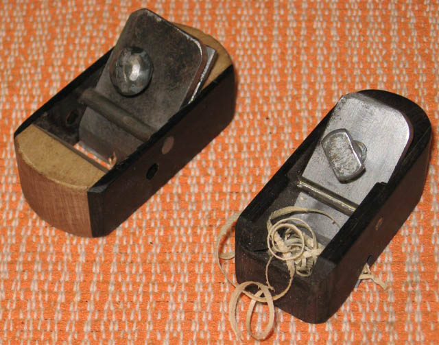

I use a long chisel and thee 2 small homemade planes
The blades in these are 3/4" wide.

I also should elaborate a little on my earlier answer, I use this little handmade brass plane 1/2", and I use a chisel and sandpaper to finish.

They range from a chunky 2 1/2" long with a 3/4" blade down to about an inch long with a 3/8" (IIRC) blade. They work great. I also have a small curved sole Ibex (30mm ?)which is perfect for feathering down the brace tips & smoothing scallops.
The bulk of my carving is done with planes, but I use a chisel for "scooping" ends & removing the main bulk in the scallops.

I use the Lee Valley rosewood planes, one of which is chopped to look just like one of Alains above ... the other not quite as short, but modded as well

His planes are quite nice, especially since he just sort of hobby builds them. I offered to help market them but he was doing fine moving the small batches he made from time to time, that is great also when you can make something just because you feel like it and not worry if they sell or not...kinda like Hesh and all of his guitars!
